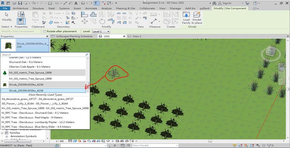

I am try to create a planting schedule. I placed three type of plant and there are only two type of plants show in the schedule. I discovered that the plant cannot show in the schedule is not in the same group of properties as the other plant. (When I was placing the plant it was in the same group of properties with other plants but after placed the plant it is in another properties.) I guess it is the reason why it cannot show in the planting schedule? How can I make the plant show in the schedule? Thank You.
Only two type of plant showing in scheduleOnly two type of plant showing in scheduleWhen placing the plant, it is in the same group of properties with other plantingsWhen placing the plant, it is in the same group of properties with other plantingsAfter placed the plant in another group of propertiesAfter placed the plant in another group of properties

That is a Site family, not a Planting family.  That is why.
