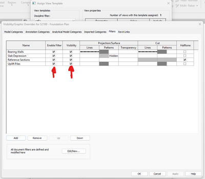

I cannot show you any specific screen shots because we do not do this, but some organizations all users to add filters that would would turn off the visibility of any section cuts that do not have an active reference.  Sections may also have the visibility restricted based on the scale (Hide at scales courser than.... )
Look at your view graphics for the view or the currently applied template to to view and see if there are filters applied.  If there are, does the name reflect what they are affecting?  If there is one that looks like it may be hiding your sections, deactivate it (see example below) as see if they appear.  Note that "Enabled" means the filter is active.  Un-check it to deactivate it.
If that is not it, select one of the "invisible" sections and see if the "Hide at scales courser than" is set to a reasonable value.
