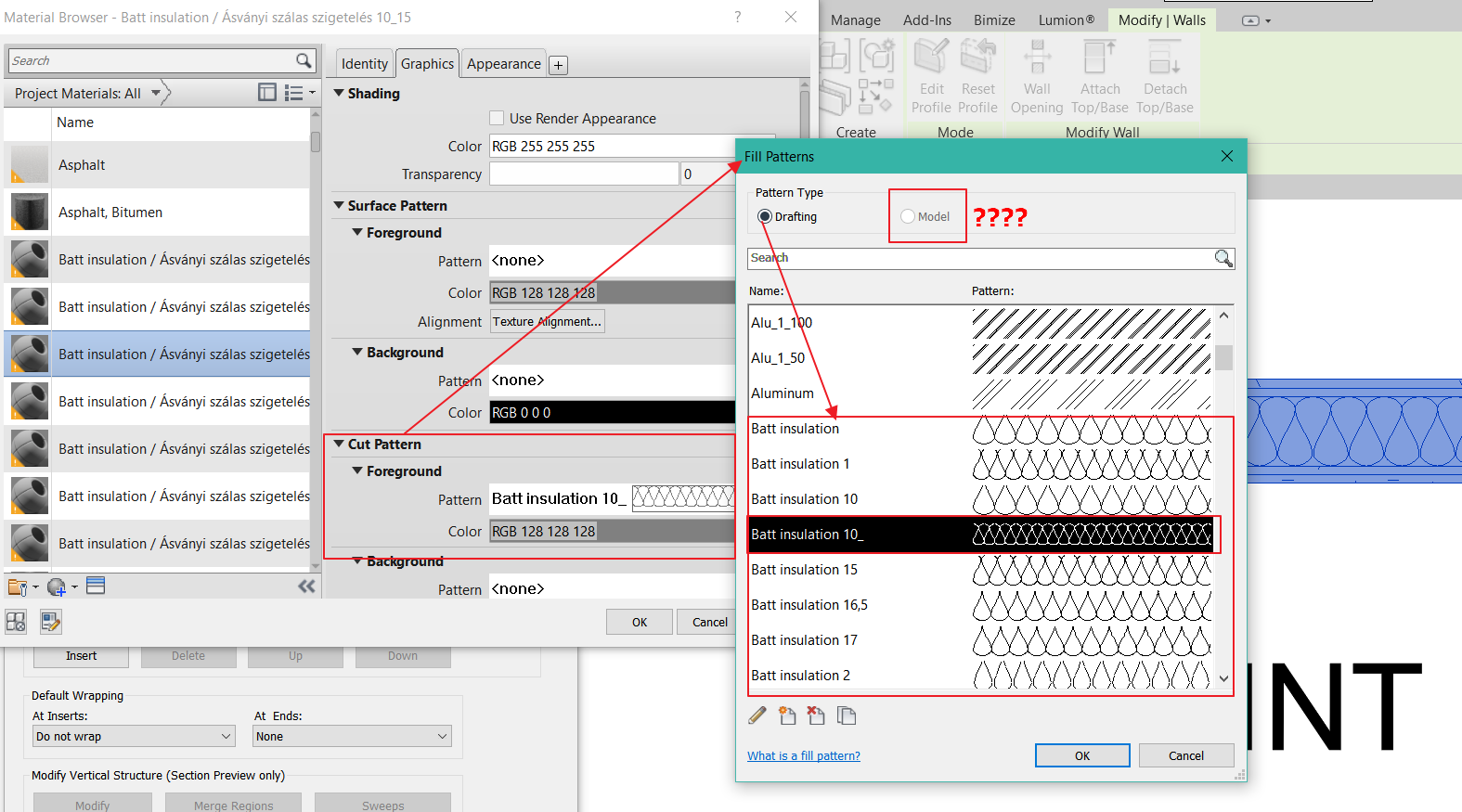

Hi Guys,
Is there a way to create a material cut pattern which based on drawing scale?
I mean - Cut pattern can only be drafting pattern -
I have batt insulation - see uploaded pic - which has to change with scale -
I couldn't find any solutions for this - any suggestions?
Also for every different type (thickness) of wall we had to created the batt insulation because the orientation was wrong - in the middle of wall.
Filtering material for cut pattern in a view template maybe for 1:50 plans are not possible because than we have to create 150 filters for 150 different size of walls...
It would be great if there would be a solution or a nested system family in walls  - where i can set material cut pattern to model based not drafting.
Thanks for any suggestion / help
Cheers
Ivo

So my problem is  - If I cut a wall in 2D ( see SS-1 attached) I want to see my batt insulation as a model fill - Drafting pattern fill for material won't change scale if I change SCALE i my view (see SS-2 attached scale in 1:50 vs. 1:100)
So I'm wondering if there is a solution for this a further upgrade for revit - or with some program coding nest a 3D pattern in System family - Walls ...
Because it is insane to create 2 type of walls 2 type of materials to have the right view of cut pattern for batt insulation - and to change it every time when I want to make an Execution plan (1:50) from a permit set (1:100)
I cant make it with filters every wall with different thickness has different size insulation and because its  drafting pattern wont fit in walls with same scale EITHER - (see SS-3)
I think we have to get rid of the standard batt insulation notation and use some other filling ..

I believe I understand your reason for wanting this...I have attached a quick snip of my wall.
I created this 'hatch' via pyRevit addin, but I have to use a "Drafting" hatch - I cannot use "Model" hatch.  The reason is when I open the wall editor and select the hatch pattern for the 'cut' pattern foreground on my wall using a material I created called 8CMU - it will only allow a "Drafting" Pattern Type and not a "Model" type.
If Revit allowed a "Model" type hatch here I believe it would save us all tremendous amounts of time.  I cannot tell you how many hours I have spent using 2D components or even using CAD details exploded to "0" layer and importing to Revit for a wall section.
Come on Revit get with the times.  And those of you who say this is just how Revit works - that's a pathetic cop-out and you know as well as I (I hope) they can easily program this type of thing in the software to make our sections read much more accurate and MUCH quicker!

@wcorbittSDHCB ...it's not possible to use model patterns as cut pattern, as you have noticed. I guess usually you would draw 2d detail item on top in this situation.
