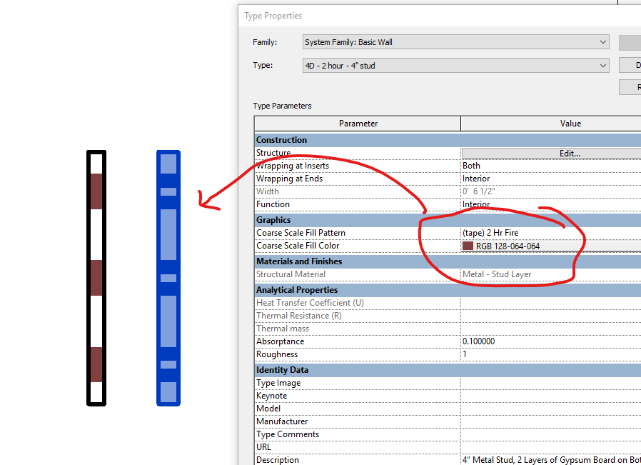

I need to add a pattern and/or linetype to walls in a Revit model to differentiate between fire ratings. Is there an easy way to do that? I've been trying to research options for about an hour now and can't seem to find a clear answer.
1,964 Views
You can add Materials  with different Cut Putterns to Wall Layers through Edit Wall Assembly dialog box.
Use Coarse Scale Fill patterns.
I know how to create a new pattern, but where are you getting your pattern designs?
I got them from the a client BIM standards, which match ours.
