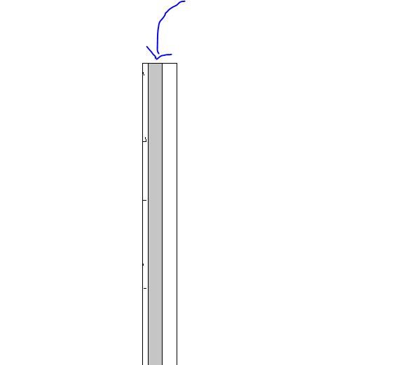

A simple wall profile copied from other project. No matter what changed, in wire frame view style, wall plan can only show a solid hatch pattern. Not able to see wall components even if I deleted the sweep. In section view, it seems OK.
Deleted view template. Adjusted view range, not working.

There is a bug for walls not having top constraint and shorter than 4'.  Make the wall like the screenshot and it should respect the cut plane.

@linkboyhello, are you trying to achieve something like this? . thanks

thank you for the extra information. It was from a stack wall. I break it up and the wall lose the constrain.
