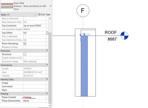

I'm trying to create a detail section of an exterior wall.  When I go into the detail, it only shows the outline of the wall.  I changed the detail visibility to "fine" and "medium" and it still does not show anything.  How do I fix this?

The problem is in the phase applied to the wall and in the viewing phase filter.
The configuration is for you to see everything, but of the new construction phase, and so you see in high definition what is new construction, and what exists you see everything solid (by its configuration).
Without having to change your phase setting, you can change the view's phase filter to none or change the view's phase to an existing one.

It worked, thank you!!
