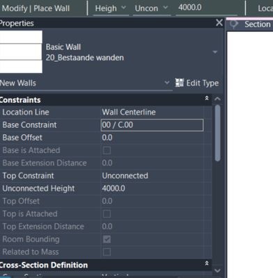

Hi could someone help me out, everytime i try to draw a wall (with this template) on a level the properties always default the baseoffset, and the top constraint is always the same level as the base constraint (image 1)(image 2). When i try to edit the properties before drawing i get an error (Image 3).... Does anyone know what i can do to fix this, i think its a problem in the template but it seems fine to me...(image 4)

@r0892934 wrote:
Hi could someone help me out, everytime i try to draw a wall (with this template) on a level the properties always default the baseoffset, and the top constraint is always the same level as the base constraint (image 1) SEE MARKUP ON THE IMAGE YOU POSTED
When you start the Wall tool and before you click or place the wall, check the Contextual Bar and make sure to select Height instead of Depth
r0892934
I can't click on it...(even before i click or place a wall),,,, could it be that there is a differnce i what type of wall it is? because if i look at te walls in the template; one wall i can edit in height (image 2) and the other wall , the one that i used, is set to depth by default (image 3)
RDAOU
@r0892934
Only for foundation walls, this option would be locked. Foundations are placed downwards. otherise, refer to previous reply
r0892934
Okay i understand, i kept using foundation wallss. Thankyou very much
