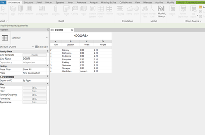

Please help me. I have lost project browser. It's n in the user interface option, but it's not showing up on my screen. i've uninstalled and reinstalled it, it's still not there.

TThank you for your reply. It has not resolved my issue. It was fine before, but I'm not sure why it suddenly changed. Is there another way for me to see all views?

could you post the screenshot?

Please find the attached. All my files are showing same( deactivate other tools and not showing the views such as floor plan elevations,etc.)

The deactivation of tools is only occurring in one of my projects.

Plug in another monitor, if you have one. Unplug your current monitor from your computer, wait a few seconds or so and then plug it back in.
If that doesn't work, I've got nothing else.

How many monitors do you have for your computer.
Have you gone to the windows display settings (right click your desktop and click display settings) and messed around with all these settings for each of the monitors?
