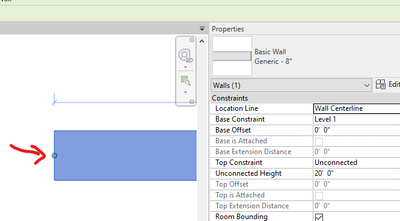

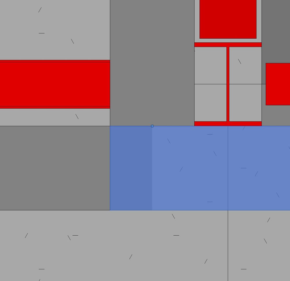

The center wall drag circle is in the mid point is there a way to adjust it and leave it at the end. Ive already tried draging the ends but nothing happens.ball drag.JPG

Right-click that circle, and select Dissalow Join, then drag it away and drag it back to where you want it

Not understanding. Do you mean that you want the Wall to have two end points like a Beam has?
So instead of this
you want this?
then change the wall location line.
