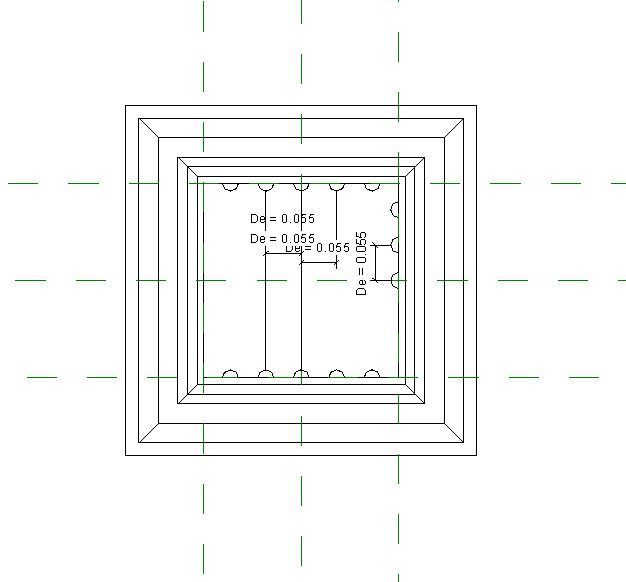

I am trying to make a square column with parametric splines, which when changing its width and depth adds or subtracts void revolve, but when changing the measurements the voids do not move with the face to be cut.
Typically I wouldn't array void because it will break. So create a face base family and add your void there. You can array it and create the the affect you want. See attached
