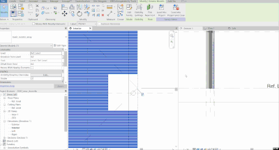

I'm making a nested parametric door family. I've simplified a family for this forum post to show my problem.
I have nested multiple families in the door. The door (including the grill) has parametric height and width values.
I want to cut out a part out of the grill using a face based void. The void is locked in the same place, but the door + grill move up and down.

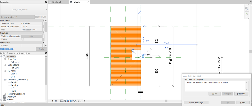

This works fine. Until the void comes at a certain height, when the error messages pops up: "Can't cut instance(s) of x out of its host." But I want the door to be fully parametric.
- Could it be related to the Cut calculation (0.79 mm)?
- Or the void itself?
Love to hear solutions/workarounds!

Sorry I didn't have access to Revit earlier so I was making an assumption based on your description. I downloaded the family you have attached. I could move the face based void fine without it failing to cut. It might have been the constraints you had in the Array. I am not sure since I was unable to recreate the error.  (Watch GIF below)
The revised Family attached with this reply seems fine try it out.

However, when I'm moving the void up I still get the error message. You see the dimension line from the RP of the handle. Is this problem due something in my settings/revit?
Thanks again for taking the time to answer my questions!
