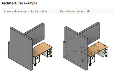

You are right, they are two different things.
One is a Visual Style. the Hidden Line visual style shows all edges and lines unless they are obstructed by surfaces.
The other is a graphic display option that allows lines hidden by a surface to be displayed:
Help | About Hidden Lines and View Discipline | Autodesk
This content was generated by a human who can make mistakes. Please verify important information.
Ryan_GormanKT36T
Hope that helps.
Here is another page that might give more context:
Help | About Hidden Lines | Autodesk
