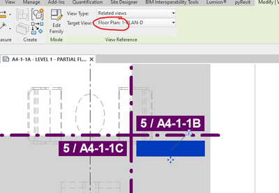

View Reference does not allow users to reference Area Plans. Please allow the "View Reference" tool to reference Area Plans for the use of enlarged plans in conjunction with the "Matchline". View Reference works for 3D views, Drafting Views, Sections, Elevations, Floor Plans and Structural plans but not for Architectural Area Plans. <revised>

View Reference does not allow users to reference Floor Plans or Area Plans. Please allow the "View Reference" tool to reference Floor and Area Plans for the use of enlarged plans in conjunction with the "Matchline". View Reference works for 3D views, Drafting Views, Sections, Elevations, and Structural plans but not for Architectural Floor Plans or Area Plans.
Huh?  What version of Revit are you using?
benhagerman
Revit 2022
Silly question, but I have to ask: Do you have Floor Plans?
benhagerman
Actually a good question, I need to revise my Idea. I don't use floor plans, but when I added one to my project the Floor Plan option in the View Reference drop-down became available.
I currently use Area Plans for all plans views. I will revise the Idea to only mention Area Plans, and may rethink the use of Floor Plans. Thank you!
