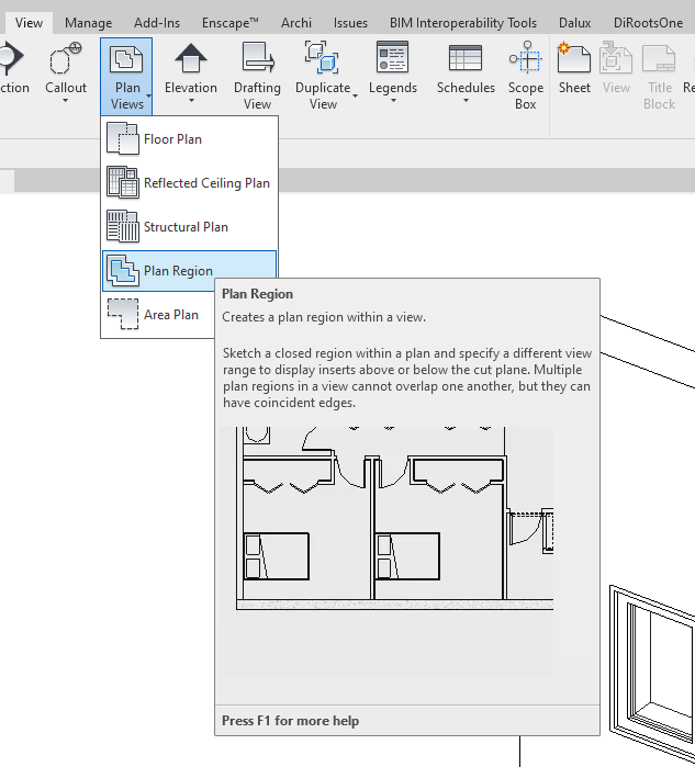

kartik_ngagerUX4M3
How can I set up a view range in Plan view such that if one window is @4' and the other one is @8', both are visible on the same plan?
315 Views
1 Reply
Reply (1)
se.ha
Hi @kartik_ngagerUX4M3,
if everything except for one window is displayed correctly I would just use a Plan Region set to the desired height:
