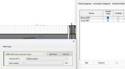

Hello. I have 2 files with nearly-identical structural IFCs attached, I applied a view filter in one without any trouble, but when applying to the second file, the desired elements are not hidden. Here's some reference images:
The filter "Voids MET" works normally. Only the "Barras MET" don't. Am I missing something here?

PedroAndruccioli
Still not working. I even tried creating a view filter called "Walls" with "Type Name" has a value and no walls were hidden. It appears that only one filter "Voids MET" is working. Any other filter i try to apply to any other view don't work.
Also audited the file. I'll try updating my video drivers, but it doesn't make sense since it's working 100% on the other (almost identical) file.
Below the image of the filter with something that should ignore the case sensitive matter.

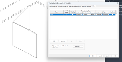

A sample file is attached. I've just made it based on a standard template, here's my screen:

SteveKStafford
The criteria in the sample you posted is not what you showed related to your original images. What are you trying to hide and why?

PedroAndruccioli
Unfortunatelly I can't provide any files.
What I'm trying to do is to hide these bars (see image) that don't show correctly from the IFC. The parameter IfcDescription is available, and I filtered it on the other document using the "RD" that all those elements have in common. But it's not working on this other file.
Do you know if there's any limitation regarding filtering links that I may be overseeing?
