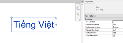

No issues here.  I actually did not need to use Unikey at all, just installed Vietnamese Language pack for Windows 10 and set the keyboard to VI when I need to type in Vietnamese.

We tried as your saying. The Arial font is working on the sheet, but not with the title/border family, weird boxes still there, as said earlier. For now we made do with both Vietnamese (without accents) and English in parentheses for the border and try to be brieft. The Vnm associate is now going around town to ask for solution from his friends who use Rv.
