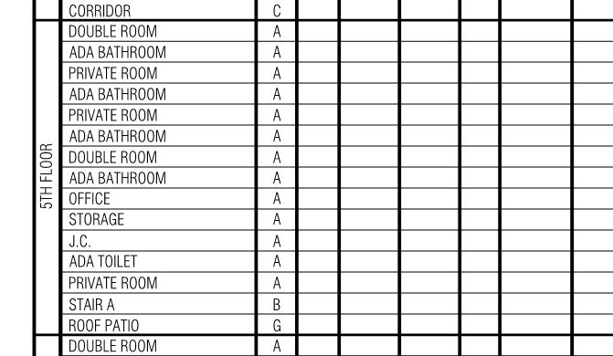

I need to group rooms by floor.
I know how to get a column to show the level.
However how do I get it to look like the attached image?
549 Views
The is a Level Parameter. Add it to the Schedule and Sort/Group by Level.
...oh, I see.  You can't do that through the Schedule. You're going to need to do that separately from the Schedule on the Sheet  -- if you really need it formatted that way.

Revit schedules will not create the first column as you have it. You can sort the schedule by Level. This would be the closest you can get it.
