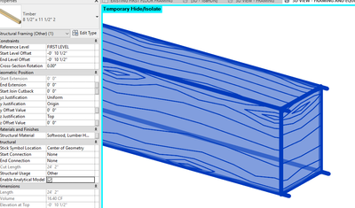

Thanks to forums like this I have found so many answers to Revit issues I have had. I really appreciate all of the help people are willing to provide using this program. This is the first time I have had to post anything, as I have not been able to find a resolution to an issue I am having with some family surface lineweights.
I am working on a model that has a lot of structural timber families. These timbers have a material assigned to them which has a wood grain model pattern assigned. I have made it grey for visualization purposes.
Most of the timbers appear in drawing views and 3D views with a "thin" grain pattern, but a minority have a "thick" grain pattern. Oddly these are the exact same families....I open the family files up and they are the same name and have all of the same attributes. I did not originally create this model so maybe there is an issue with how it was built.
My understanding from searching for an answer to this is that there is no way to control the lineweight thickness of a family, at least directly. I have noticed that when I copy the thicker grain pattern timbers the copied version is thin grained. I can go thru and copy these all in place and then delete the ones I don't want but it is a bit of pain as there are a lot and they will need to be retagged. Also, I feel like I could do this and then it could reappear as thick again or something.
I already had an issue with this model which I was able to do a  workaround on which was that I had grids turned off in a view template but they were still showing in the views that the view template was applied to. Every time I closed and opened the model they would be there. I tried everything including auditing the model and eventually just turned them off manually!
Below are images of the variation in lineweights that I am seeing, any help would be greatly appreciated.

Are you sure they aren't coming from a Filled Region?

thank you for the reply. How do I get to that?
When I go to the instance or type properties for the timber I do not see a graphics option with fill and lineweight setting. I do not see it when I click to edit the family. I should have mentioned this is Revit 2018...is that feature available in 2018?
How do I edit system family: filled regions...I do not see it in the project browser. Just when I thought I was started ti get the hang of this program!

Never mind the Fill Pattern.  Post the file.

The link to the model is below. I have noticed that I can copy the beam with the thicker lineweight over "x" dimension and it will appear with thin lines. However if i copy and paste in place it has thick lines. I also tried copying the entire model into a new file and then all of the beams appeared with thick lines....

I can't figure it out. Why don't open a support case through your Autodesk Account Portal and submit to them to troubleshoot.  If you do, can you report back to us what they say?   I'd love to know.
FWIW: Revit material hatching patterns are displayed and printed using the Revit line-weight number 1, except Ceiling surface patterns which use line weight 2. This number is then converted to a line thickness according to the scale of the view on a Line Weight matrix chart accessed from Additional Settings on the Manage tab.

Not sure what causing it but you can cut and paste the affected members in place.

Also, simply duplicate Type will fix it.

@Anonymous do you have the original source/pat file for your wood_5.pat i could dig into? I don't think this is a PAT file issue (and as everyone else is thinking, probably some weird thing with revit). I loaded in other various model patterns and it was having no effect. Could always check to see if it has some weird errors or something though.
@Anonymous Check to see if this solves your problem... Edit the family. Go into the material. For the texture alignment, click it around, like 5 arrow up, 5 arrow right, etc... Make it stop a place where it wasn't. Then re-load back into the project. This solved it for me. :Gesicht,_das_eine_Umarmung_gibt:  (if it doesn't solve your problem, maybe try one or two more alignment positions, maybe i just got lucky).
My theory is that it may have to do with the PAT alignment for 2 reasons. First, since various PAT files were running into this its probably not the PAT file. Secondly, I noticed taking some of the beams and adjusting size/extensions to the ends was triggering it, which makes me feel like it was an alignment/origin issue. This seemed to fix it for me, but i tested in R2019.
