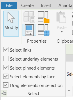

The functionality of this feature has been reversed since Revit version 8 or 8.1, meaning in 2005, shortly after Autodesk purchased it. Before that, it was always checked/true until manually unchecked by the user. This change was made due to numerous user complaints. Personally, I can totally understand how it could be convenient for some users, but for the majority of users, namely BIM coordinators and managers,  work across multiple disciplines. Having this option default to "Editable Only" would be a nightmare.
Add to that the fact that it is a contextual option. Meaning it is only available when the Project is workshared with worksets loaded/open. Hence, there are users who have not even heard about it or affected by it
I’m not saying you shouldn’t get what you’re wishing for; I’m only clarifying that it’s not a bug. That said, you really need to post this request on the Ideas Forum.
I’m 100% sure the dev team wouldn’t find it too hard to implement this option in a way similar to "Select by Face" or "Select Pinned Element," where users can choose to keep it always on or always off. Below is the link to the Ideas Forum.

It seems that this should be a persistent application setting instead of selected by model. Maybe it could be selected by model, but I don't know if the model stores persistent user settings. Even if I had to select it once per model open, it would be an improvement. This post started as an Idea then  kimberly_fuhrman-jones moved it to the support forum.

I dont know it depends on how long one has been using Revit. Regular users who lived through the different phases of Revit's development tend to remember annoying options
Programatically speaking I do not see why it could not or should not be implimented somewhat similar to these selection filters/options where one checks unchecks as desired.
