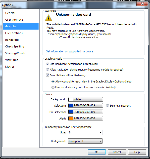

Dear All
I've a licensed Revit 2016 version all flavor. Installed in my machine an Nvidia Geforce GTX650 VGA card.
Some times the option "Draw visible elements only" is unchecked and dimmed and I tried it on another machine it is enabled and it is not working.
Any ideas?

Not sure if it helps but this appears fine on Revit 2016 and GTX770
on your screenshot the card name appears different (GT 130M) are you sure you have the correct drivers installed? Is it on a laptop?
Mustafa.Salaheldin
Dear Koulis
Thanks for reply.
The 130M is my laptop where I did the same test.
In the GTX650 machine the option is totally gone:
I noticed that in the case the option is dimmed the build number is: 16.0.1063.0 20151007_0715(x64) R2
In the case the option is gone the build number is: 16.0.490.0 20150714_1515(x64) Service Pack 2

Mustafa.Salaheldin
The "Draw visible elements only" option will only appear when installing Revit 2016 with R2 update.
It will show up in both licensed and crack versions.
In my case (in 130M case) it may be not active because my VGA driver is not compatible.
