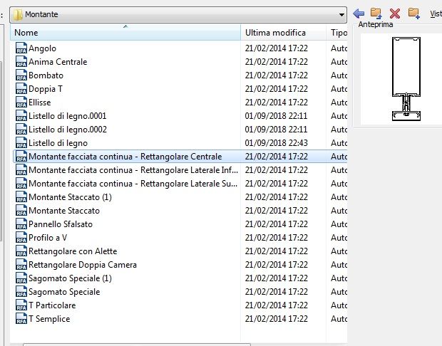

Uprights types
trying to do a curtain wall and putting different upgrips in the central grids.
As in the first screenshot I can put only rectangular or circular mullion.
If go in insert family there are a lot of different of them but I don't find other can put in central grid.
I can only create other mullior from new to have different upgrid in central grids?
Thank's

Do you understand that Mullions are extruded geometry created from Profiles? Look under the Mullion Properties and you'll see what Profile is being used for the Mullion Type .
Message 3 of 11
@barthbradley  you sayed circular and rectangular are create from new?
Actually there aren't here.
Message 4 of 11
That's a DETAIL, not a PROFILE.  You are looking in the wrong folder. Go to subfolder named "Curtain Walls" that is in the "Profiles" Folder.
...Or create your own Profile using the Profile Template and then set "Profile Usage" Parameter to "Mullion".

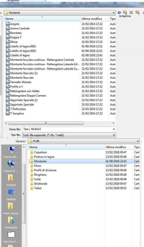

Message 5 of 11
@barthbradley
No is Profile. Maybe i find the rhight way.
Thank's!

Sounds like you did exactly what I instructed you to do: change the Profile of the Mullion Type.   Is that the solution, @Anonymous ?
Message 9 of 11
@barthbradley  no the solution is yours messages 2 and 4.
I don't undrestand how cam I do to create a new profile however.
" using the Profile Template and then set "Profile Usage" Parameter to "Mullion". "
Have to create a new family follwing the steps in the screenshot.
Otherwise can show me a scrrenshot to undrestand?
Thank's very much.
Message 10 of 11
