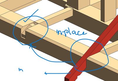

it seems to be a old question long ago, now happend again:
i made two simple projects all the same --- a grey box (in-place) to be cut by a red in-place, but one can be cut, but the other cannot. (error "unable to cut a host containing instance"), but they two are the same.
anyone can see the difference between these two grey in-place box?

attached are two files which almost the same, but one can be cut (grey box), the other cannot, (the red one is fine)
anyone can see the different between the two grey box? (one with error of "host containing instance")

"Wrong" one seems to cut okay using Join Geometry in the correct Join Order. No?

Don't Cut. JOIN using Join Geometry tool. Join Geometry will remove geometry at the union.  Six of one; half dozen of another.

@heichan88 wrote:
 can i export this grey box to the family while keeping the cut holes?
You won't be able to save the In-Place modeled grey box with cut holes to a standalone loadable family since the holes are cut outside of the In-Place Family with another element in the Project.  You CAN save an in-place modeled component out of the Project Environment (RVT) to a standalone Family (RFA). To do this, Edit In-Place Component, Window-Select all the elements, Press Create Group button, name Group and save, and then right-click on the Group name in the Project Browser and press Save Group. Afterwards, exit out of Edit In-Place Component mode.
You could also Group together several In-Place Modeled Components and save that group to a standalone Project (RVT). To do this, right-click on Group name and press Save As.
