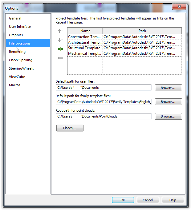

To change the default file and folder locations in Revit:
1. Click File > Options >File Locations.
User-added image
2. On the right, click in the box next to Architectural Template, and click the button with 3 dots that appears.
3. In Browse for Template file, click in the drop-down next to "look in". Go up one level to the Templates folder. Choose the template folder you want, and then choose the desired template.
User-added image
4. Repeat for the other templates.
5. Below that, look for "Default path for family template files", and click Browse. As you did with the template folders, go up one level to Family Templates and choose the appropriate folder. ( NOTE: English is Metric, and English_I is Imperial.
