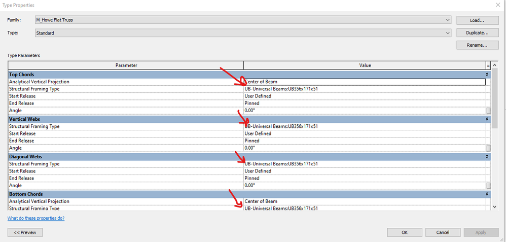

select the truss, edit type, then select the member types for Top chord, bottom chord, diagonals and verticals.
If they are already assigned, then you need to make sure that visibility is also on for structural framing in view.
Mostafa Elashmawy
Thank you for the advice. Unfortunately after following the suggested steps it hasn't resolved the issue.

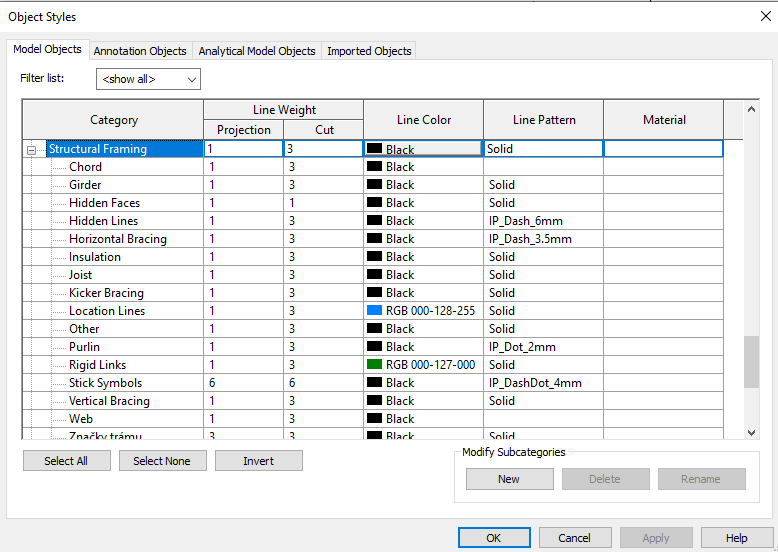

Go to Manage>Object style>Structural Framing and change line style.Capture.PNG
s.borello
Follow the advice from @XXalessio.amodioXX... that's your solution.

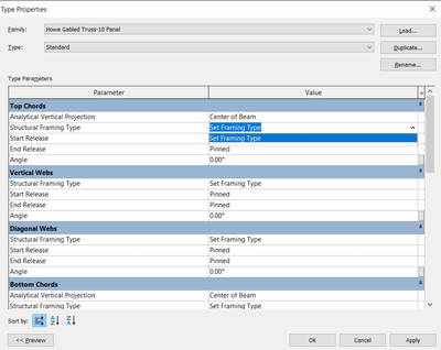

did u know why i only showing 'Set Framing Type'
