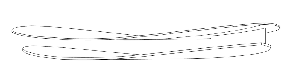

Recently at work I have been tasked with creating the accommodation deck within a ship. This poses some obstacles that I can't seem to find tutorials on how to work around. My plan was to model the structural boundaries within Rhino 3D and then import into Revit to then generate the outfitted accommodations (joiner bulkheads, doors, windows, etc...). I am currently having trouble setting up my Revit project to have the decks as boundaries as they are curved with both shear and camber. Here are some screenshots of what I have so far:
Is it possible to trim joiner bulkhead by a curved surface? Is Revit the correct program for this type of task?

You can create a Roof by face from the curve surface and attached the top of the walls below (as you show in your second pic) to it.
Message 3 of 29
How do you attach a wall so that it follows the curvature of the roof?
Message 4 of 29
Select the walls, click Attach top/base button, select the roof.

Oh you have to create an in-place Mass and import the Rhino in the Mass.
Message 7 of 29
That worked! I'm now trying to assign both upper and lower decks as boundaries (they are masses) although the lower deck is able to use the "Roof by Face" command on, the upper deck is unable to be selected for either the "Roof by Face" command and or the "Floor by Face" command. Here is what I have so far:

Ignore the warning because you don't need to compute any of the listed items.  The meaning of it is that Revit, by default, expects a Mass to be a sully enclosed 3D volume in order to slice Mass Floors.  You need none of that.
For what you are doing, do not use Floor by Face, use either Roof or Wall by Face.  It's hard to tell why you cannot create a roof for the upper deck.  Did you try to create one by one or multiple roofs at a time?  Try finish one roof then move on the other.

I still can't seem to make the surface a roof/wall. Are you aware of any limitations in Revit regarding surface complexity (double curvature within the surface)? I can't select the surface when trying to create these masses "by face". Here is what I have:
1.PNGThe lower deck I had no trouble with as I think it has to do with only having curvature in one direction. If you have any input on why I may not be able to select the singular surface during these commands I'd love to read it.

I can only create a roof for 1/2 of the form by export it to a SAT and link it back.  I think you need to split the NURBS form to 2 or more pieces in Rhino and try again.

My thoughts? I would not use Revit if I could not build things natively in Revit. With that said, the forms you show can be built directly in Revit conceptual mass. They may not be exact but can be close enough.

I believe the upper deck is now correctly made into a mass. Can you check out this file and give me input on why the wall won't attach it's top to the deck?
Message 19 of 29
cbcarch
-Can't Attach a Wall to a Wall--the upper deck is a Wall. For some reason, the upper deck will create Wall by Face, but  Not Roof by Face? Maybe the thickness of the roof needs to be thinner for it to resolve geometry?
-It needs to be a roof, then the vertical wall will attach to it.

Message 20 of 29
