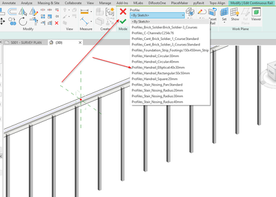

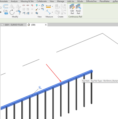

Default profile means you are not committing to particular profile, and you can edit it by selecting the rail (tab select ) and use sketch or any profile on the fly.
Have a look at these screenshots.
Default ( there is no dedicated profile for this)Default ( there is no dedicated profile for this)Select the top rail and edit rail.Select the top rail and edit rail.Choose any profile or simply sketch it...Choose any profile or simply sketch it..Choose any profile or simply sketch it...Choose any profile or simply sketch it..I chose elliptical here for example.I chose elliptical here for example.
