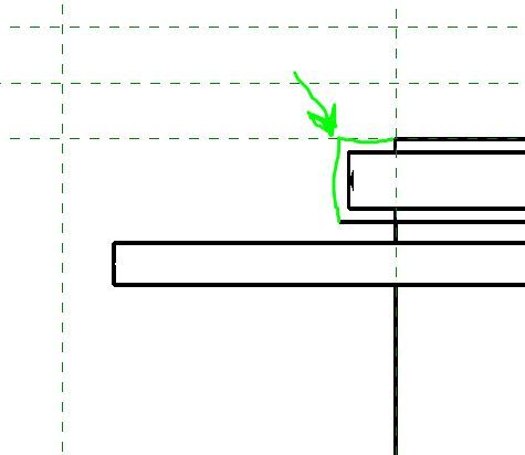

Thank you for offering to take a look at the file - it’s included in this reply. I appreciate any other suggestions. While you’re looking at it, do you have any idea why the ends of the stringer (green arrow below) appear in 3D, but not in plan?  Thank you again!

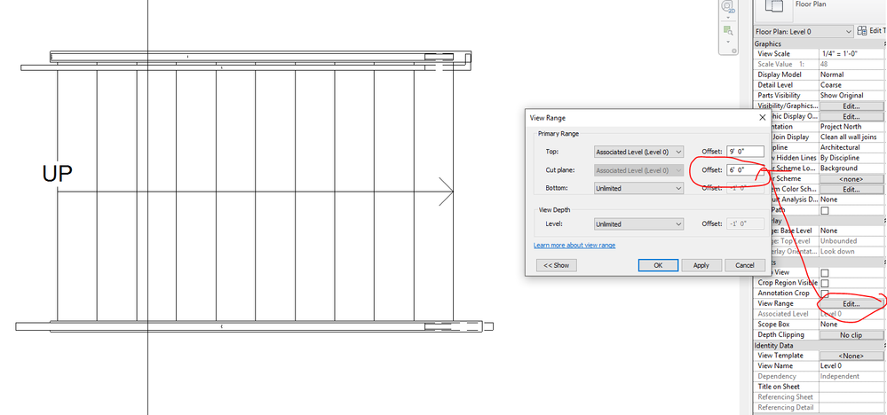

@PhilvK
For some reason the extended part of the stringer of a stair by sketch only shows when the cut plane is high enough to show the entire stair.
Message 8 of 11
PhilvK
Do you know if it is true that once you change a stringer to a ‘real’ steel profile, the stringer can’t be extended by editing even if the stair is converted from ‘component’ to ‘by sketch’
Message 9 of 11
Stringers cannot extend pass the first nosing if you create a Stair by Component, even when you convert to Sketch in editing mode.  It only works for the true Stair by Sketch.
One thing you could do is modify the nosing profile and tread profile to provide offset from the actual control line.
Message 10 of 11
PhilvK
Can you add just a little more info on how that nosing profile elates to your stair example and how its forcing the end of the stringer outboard of the nosing? I kind of understand, but not fully.
Message 11 of 11
Modifying the nosing and tread profiles does not extend the stringers out, but push in nosing and the tread in.  So it gives the same effect.
I will upload a screencast in a few minutes.
Edit:  It only works for 3D and section/elevation, unfortunately.  The stair plan still shows with the original nosing lines.
