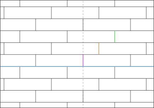

I'm looking for a .pat file that represents a staggered end joint pattern. I can't seem to find one that doesn't have a repeating 'H' pattern to it like a brick course. Attached is what I'm looking for. Also, I would need it in 9"x36" planks. Is that possible?

I can't image how that could be repeated to make staggered 9"x36" planks.
Totally possible...you have to modify a PAT file accordingly.
Look for Pyrevit on Google....it's an add-in for Revit that includes a pattern creator.
now 4"x32" on the other hand...that I could see.  Smiley Wink
Pattycake_Kyle
You are trying to do something like this?
Those are 9" x 36" Tiles with 12" offset each. Download the PAT from Here: https://pattycake.io/pat/6GWV5yB7EPB

I downloaded pyRevit and it is very user friendly. I got the pattern I wanted. Thank you for your help!
