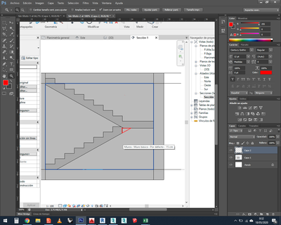

Hello. Is it possible that REVIT draws this part? It is a U shape Satair

No issues here.  Share your file.
Message 3 of 13
I share
Message 4 of 13
Just edit and redo one flight and landing. easy breezy.
End with Riser checked + flight/landing redone:
End with Riser unchecked + flight/landing redone:

Thanks a lot. Can I get rid of the arrow?

Yeah, but you still have Warnings even with @ToanDN solution.  Or, did you not notice? Just saying...

Do not understand what you means with lawyers etc. Anyway, i also have this issue with the railing, it does not get the upper part of the stair.

well, i did, the thiferent parts, different measure so it has 2 cm in the middle, but i get this ugly thing
