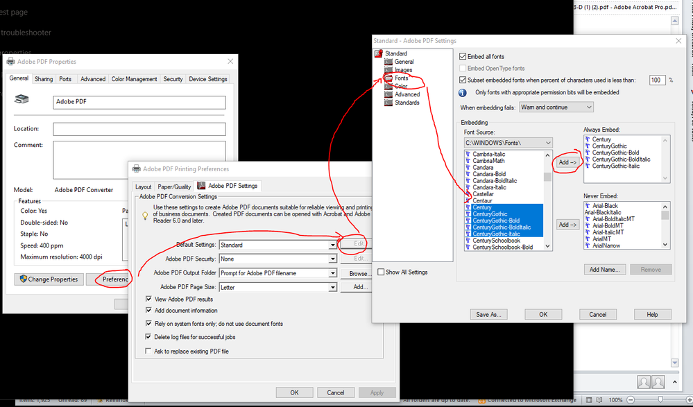

Set you PDF printer to embed these fonts.
Nachricht 6 von 6
als Antwort auf: ToanDN
I like this tip,  thank you.
The thing is we sent DWF. sorry dint mention this before. I dint see anyway similar setting while exporting DWF.
The font is Century Gothic.
