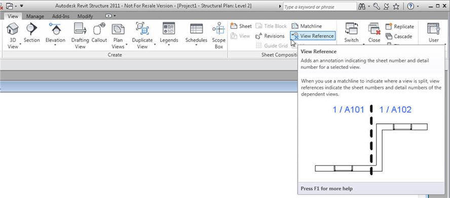

I have created a dependent view and a match line but when I try tagging it the match line will not highlight.  I went to annotations to see if I could find a tag for match lines and didn’t see anything.  What am I doing wrong.

You can tag Matchlines with the View Reference tag:
