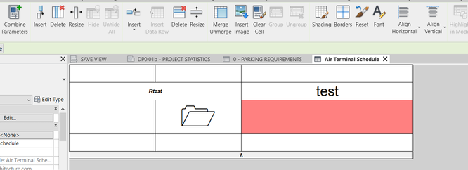

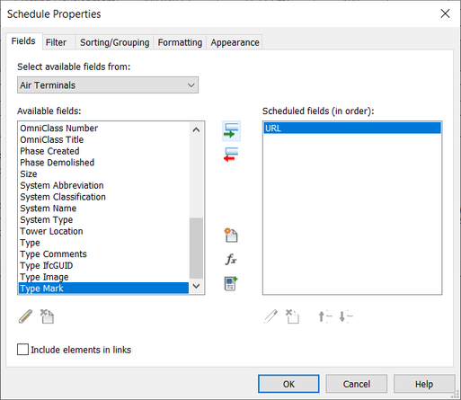

You can create custom schedule. First choose the schedule which you not going to use.
Add one parameter
Check off Show Header and turn off the grid lines and outlines
Now select the title cell and clear cell
Now you can create customized schedule. Use insert row/column if you want to add new cell. Use merge if you want to merge two cell together. As well add shading, border or change fonts.
Once you master the tools above, you are now able to create customized schedule to suit your need.
Message 6 of 18

Out of curiosity...Why a schedule of a category that he is not going to use ever? I thought custom schedules where actually intended for Multi Category where they actually become useful!
Apart from the above, Custom schedules cannot achieve the format of the schedule posted in the OP...if it can, would  you be kind and elaborate on how one can add a multi line header under the same columns of  input/reporting  parameters?
