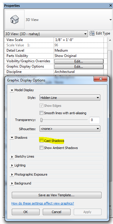

How can I remove the sun shadows from my 3d view?
Thanks in advance

If you want to turn off the shadow altogether then just uncheck the shadow button.
If you want to keep the ambient shadow on and the Sun shadow off then change Sun intensity to 0 and increase the Ambient intensity.

I still have my sun and my shadows, sorry.
Soytei
I want to remove the sun too because it creates darkness in my walls, as in your cylinder, How can I deactivate that?
