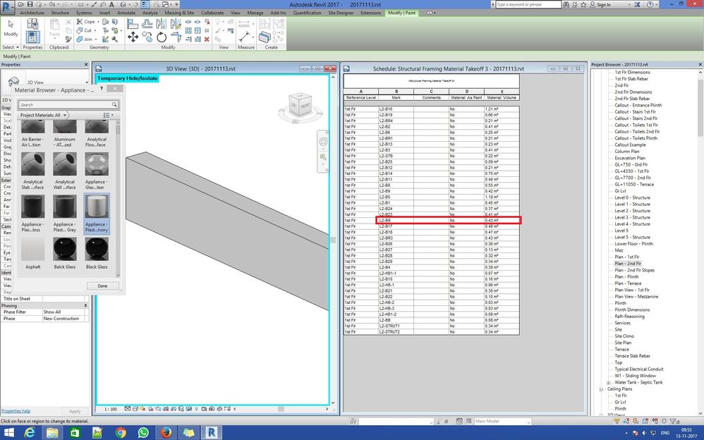

@ToanDN, No the technique is not working. Image-3Image-3
Image-4Image-4
Am not able to pull off the paint area. Instead it just adds another entry of the same Beam in the schedule with zero volume.
Message 5 of 18
Volume? I thought you needed Area. Paint does not have volume.

Message 7 of 18
Oh! @ToanDN now I understand what you meant. I was earlier looking for the Area quantity in "Material:As Paint" Column, and was wondering why it just said "No" instead of mentioning some Sqm or SF. This is the learning part for me that the paint area as well would be mentioned in "Material: Area" Column. This solves the problem.
Many Thanks.
