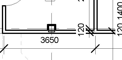

I've seen similar postings but nothing helps....
We have walls which line up with hollow structural steel columns. revit displays the gypsum layer as passing through the columns (ie we see lines within the hollow part of the column). I've created a furring wall typ but can't seem to cut or join the walls.
Is there a way to get this to display correctly or do I have to create 2 separate walls on either side of the column?
Thanks a bunch!

Are you sure that you created that column with the Structural column tool and not with the Architectural column tool?
Message 3 of 12
in reply to: Anonymous
Pretty sure: when I pick the column it is named "M_HSS-Hollow Structural Section-Column".

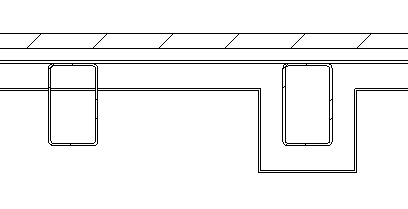

I think this is a case where using Architectural columns and structural columns together will get the results you are looking for.  The wall finish will wrap around an architectural column when placed engagued in a wall.  You can use this behavior to establish the "wrap" around the structural column contain within the architectural column.  In the attached image the structural column on the left is placed by itself and the wall goes right through it.  In the column on the left an architectural column is placed in conjunction with the structural column and the column is wrapped.

It may seem like a work-around but it is part of the intended workflow.  Per the help file:
http://docs.autodesk.com/REVIT/2011/ENU/filesUsersGuide/WS1a9193826455f5ff-6d855556117facf922e-1c22.htm
There is even a tool on the context ribbon when placing structural columns to place them "at columns" this is in reference to placing a structural column at every instance of an architectural column.
Using masking regions you will solve the problem in this view only and the work will have to be done if you see this in another view.  If you use the 2 column method it will be right in all views where this appears.

I am trying to do this but the link is broken. Is the architectural column supposed to be the same size as the struct. column? Or do i make the arch column the size of the wrap?
Message 10 of 12
in reply to: vanessaH6CHC
The architectural column should be the size of the wrap.  For flexibility, you can create an architectural column family with instance width and length parameters so that you can make it whatever size you need in the project without creating a bunch of types.
