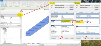

Hi. I have this staircase done in AutoCAD and need to model it in revit. I can't think of a way to overlap the treads. I used assembled stairs but could not overlap the treads. Is there a way to solve this?

Add a nosing to the stair tread…the nosing is what will overlap the step/tread below.
https://help.autodesk.com/view/RVT/2024/ENU/?guid=GUID-7189B9BD-8028-421B-967A-8DEA8B25BDC9

This is so cool, thank you!
