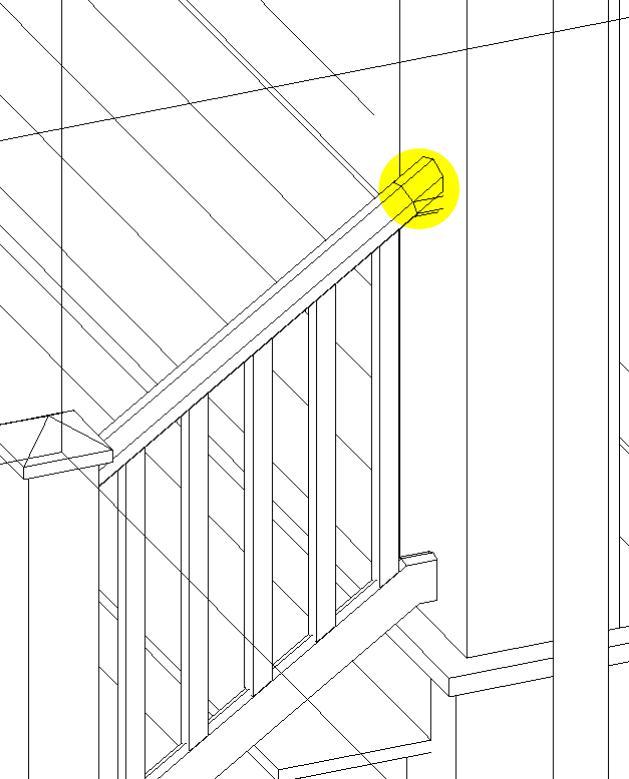

Is there a way to allow the top and bottom rails of a sloped railing to stay sloping instead of flattening at the end of the railing path?
I tried to modify the path of the top rail and can get close but cannot 'delete' the line segment creating the flat portion of the railing.
Below is the original version and a version with the modified top rail.  Ideally the top and bottom rail would continue to slope to the face of the column.

Actually, your response had me making adjustments and I stumbled across the 'Use Landing Height Adjustment' option.  Checking the box and extending it by 4" created the condition I needed.
