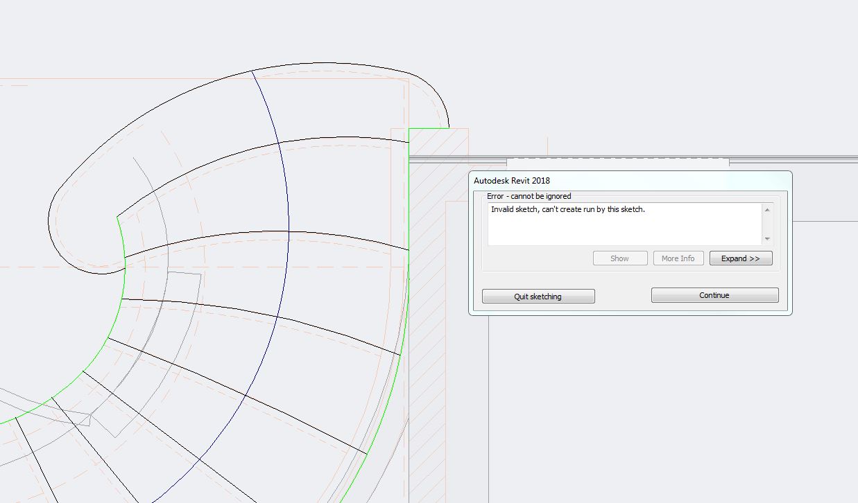

Hello I'm trying to do a stair with the following design but I can't get it to work, Can someone give me an idea How can I get this stair done?
Maybe is easy and I'm just burned already from the day, but I can't find the solution, this is giving me this error and it's not even showing me which part exactly Revit can't do, I tried taking out that first step and it works, but that step is part of the design so I can't take it out.
Thanks for your help!
Revit 2019.2, Windows 7

Boundary is wrong. You got riser wrapping around it.

Connect riser lines between the left and right boundaries

Model the bottom step as an in place piece.

No, I don't think you see at all, because this IS THE SOLUTION. Connect riser lines between the left and right boundaries, just like I said AND showed you, and the stair sketch will work -- WHETHER OR NOT YOU CURVE THE SECOND TO LAST RISER.

No offense taken. Just trying to explain that you can do exactly what you want using stair sketch method, as long as you follow the rules that I demonstrated --- even with a squared off second riser. Try it. You'll see.

The solution you propose it works if the 3rd step would begin where the round of the 1st step ends (I tested), but unfortunately this is not the case (see pic), and I can't not make that change, because the stair is being built already. I'll stick to the model in place for the 1st step it's working good so far, and I can't spent more time just playing around to see how I can get it done, it will be for other project. Probably I just need to go and learn more Revit.

Oh, you mean something like this:
Message 16 of 26
Can we see it in 3D?  I can sort of make it but the bottom step riser doesn't look right.
Message 17 of 26
You did good @ToanDN. I see a tell-tale sign that you figured out how I did it.
Message 18 of 26
@ToanDN: Hope this works for you. This is same stair as shown in Plan View above. As you see, riser wraps fully. Stair3D.jpg
