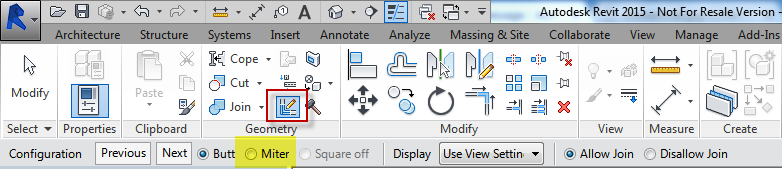

By default the walls join by butting into each other...try changing the wall join to miter...it will look the way you want it to in an elevation...when they butt into each other they look the way you see it in the image on the left in an elevation view.
To edit the wall join, go to a plan view, Modify tab, Geometry panel, select the wall join tool, then place your cursor over the wall corner, click to place the box at the corner and then on the options bar set it to miter.

  2. go floor by floor to solve the junction mode with the appropriate tool (select a wall > modify > Geometry > wall join). Be careful, the tools is used via the green info ribbon at the top of the drawing window: Pick a wall junction, then use the info ribbon to navigate through possible joints!
