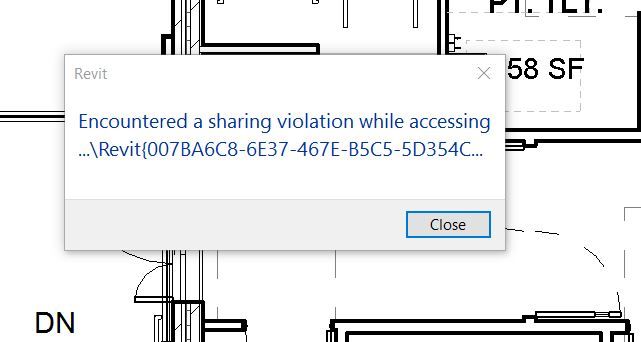

hello guys , i have a problem in revit i can't save my project , Capture.PNG

als Antwort auf: AbHazim
http://forums.autodesk.com/t5/revit-mep-forum/encountered-a-sharing-violation-while-accessing-revit-...
This is also a Windows error. May not be a Revit related.
BTW: You're the second one to post about this particular issue today.  Strange.

RDAOU
@AbHazim
it doesn't have to be antivirus (u should consider using one though), it is something which is infuriating Revit from writing/accessing the shared location where data is brig saved... It can be any of the following reasons
  1. Windows Firewall
  2. 3rd party Firewall
  3. A change to/in windows UAC
  4. lost connection to LAN/WAN server/accelerator or NAS
  5. lost connection to Internet while collaborating on A360
for us to be able to help u or give you specific suggestions you need to be more specific on the kind of setup u have, which revit r u using and which build, what were you doing when error occurred (working locally or on a network)
- Do you have all service packs / updates for revit installed?
- Did you recently update windows?
- go to Revit Application menu >> Options (or alternatively in the revit.ini) and check the path set for default saving of documents...make sure you have the right access to that folder.
- shut down revit then restart by right click on desktop icon and run as administrator

unfortunately still the problem : my internet is local and everything okay but still the problem :enttäuschtes_Gesicht: and my windows is 10 and i'm checked the firewall everything is good but i don't know why also i'm delete it and install again but the problem still plz anyone can help ?

I have the same issue. Windows 10, up to date, Revit 2017. I cannot save a file. It is not limited to one file. I have repaired Revit installation. I have turned off Windows Defender real time protection. I have uninstalled Malwarebytes...still no go. Any other ideas? Thanks.Capture.JPG
