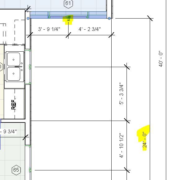

Hi All,
I want to convert my ext. walls from "painted" stone veneer walls to stacked walls with "real stone".
I have my stacked wall created but when I try to swap it out..... dimensions change as shown on the screenshot.
What is the trick to doing this and keep my core numbers to stay put?
Thanks!

Unfortunately, Stacked walls could have been a much more powerful tool than they are. A possibility that we have been discussing here has been of just creating a Wall type. Worth a try.
Your Stacked wall is 8" thick, the original wall is 7.5" thick. Accept the warnings that Revit gives you when you are switching out the wall and let the 24' dimension go away. Flip the stacked wall. When I did this I ended up with a dimension of 24'

millerew17
The lower stacked wall is 11.5" and the upper is 7.5". I tried your way and the "outside face of the core" stays exactly 1/4" out too far. That part isn't making sense to me.

millerew17
My first issue was when I swapped the regular wall for the stacked wall my wall dimensions start changing. the wall I'm trying is the 16' one at the south/bottom of the main floor. I intended to go around the whole place.
I never got to dropping the stone down to the foundation ledge because of this dimension problem.

millerew17
Putting this dimension issue aside and looking at this stacked wall a bit more, I came to the conclusion that Bart's idea of using a sweep for the lower stone wainscot is the way to go. I don't see how to extend the stone down to the foundation ledge because in the "properties edit" with a stacked wall there isn't a lock/unlock for the individual components like in a basic wall. Unless I'm totally missing something here?
That said ...my big question is how do I make a profile in order to make a "stone" sweep with this kind of stacked & staggered stone wall?
Thanks again!
Message 12 of 13
If the height of the stone consistent relatively to the wall then sweep is the way to go.  If it varies then you need more profiles to accommodate the different dimensions.  If it has slopes (i found unlikely for what you show) then sweep does not work.
See screencast:
