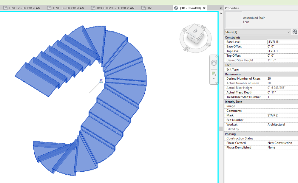

Alfredo_Medina
You can do it by sketch, like this:
1) draw the boundary lines (exterior boundary is kind of a U shape, and the interior is a small circle. (green lines shown below)
2) draw the risers. I did one every 18 degrees. The risers need to be trimmed by the two boundaries.
3) draw the path as an arc.
Finish the sketch.
Message 10 of 13

chilombe.simwami
This is a great workaround for smaller (less than 360°) square staircase, but what happens when the square spiral staircase continues for more than 360°, you can not make the sketch lines overlap.
Message 13 of 13
Create different runs, each is 360 degree or less.  The convert the runs to sketch and edit them.
Below is an example of an overlapping stair.
