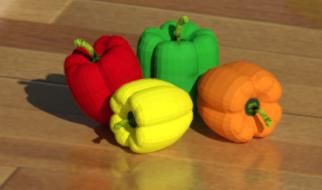

How can I do to go from Sketch Up into Revit? I was trying the new Sketch Up Import from Revit 2020, but it is not working for me. Here is a model downloaded from 3D Warehouse. The inconvenient is that when I’m importing into Revit it is rendering only grey colors. Here is the Model In Sketch Up.

… hi @Anonymous
… here is your model in REVIT
… I’m too lazy today to do the smooth stuff
… but you get my point …
