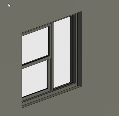

Hello. I have a collection of windows families with a similar structure like the one attached but with various layouts.
I would like to know if there is an easy way to add a Wall Inset parameter without rebuilding all constraints from scratch?
I tried multiple times with and without reference planes. Sometimes a dimension alone will flex it well but when I add as a parameter it just doesnt like it. Always says there are constraints issues.
Could someone have a quick look if there is a way to do it?

Host the Window to an Embedded Wall. Inset the Embedded Wall.

- Create a curtain wall type using a basic wall type as default panel
- Place a curtain wall the same size as the window to cut the main wall
- Move the curtain wall to the correct inset
- Place your window in the curtain wall panel

Thanks, it works, but the embedded wall cannot be exactly the same size as the window, otherwise the window frame depth will get the thickness of the host wall. Maybe I can change that from within the window family.
If I keep the smallest difference of a few milimeters it still looks ok I think
If I do make it the same size, the window frame depth will be the one of the host wall.

This works and the CW can be the same size.
But the issue with both solutions is that its done per window instance level.  Could a similar workaround be done within the family level?

if you need to se an Inset Parameter for a Window or a Door Family , then you can do it as shown in my screencast:
(view in My Videos)
I used an Instance Parameter for Inset , but you can use also a Type Parameter if the Wall hosts are more appropriate for this option..

Yes, but only 1/32" on one side (the shortest side).  The Embedded Host/Window Wall can exactly match the Window's Opening on all the other sides except one - where it needs to be offset from the Window Opening 1/32".  Not a big deal - even in BIM.
You asked for a quick and easy way to inset Windows that don't have a parametrically-controlled inset. Your only other option is to build an inset parameter into each Window Family.

Yes I think the embedded curtain wall is the fastest way to do it. I thought there is a simple way to add the Inset parameter to that existing window family but I guess  it requires more work?

Thanks! I understand the logic when starting from scratch but I thought I could easily add an inset parameter to that existing family so to offset the frame, sash and glass at the same time. Do you think it requires rebuilding most of the parameters?

it can be repaired...
(view in My Videos)
the file is in Revit 2021...
Anyway it's easier to make a family from scratch than to repair an existing one which was made following other rules,,,

if you use the embedded wall ,should change all the windows and doors(probably) and define the new Host, for all the same windows but if you change your family it is automatic happened to all sort of windows family.
I think change the family and use the Type Parameter is so faster,but it's depends to you.

Thanks for trying this! It helps me understand the process better..  Just like I thought, its not an easy  1-2-3 steps-way for an existing family.
