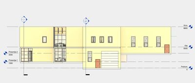

Greetings Esteemed Users,
a question:
How to show what is visible behind cut/section line?
I would like to have cross section (insides) of space with the rest of the building visible.
That is pretty much common in all mechanical 3D programs/practice, or drafting rules.
Bottom horizontal line is what I am cutting with.
How to show left and right of that central room?
This is of course cut section. Would be really informative to see left and right of the building.
Like this, but, with middle/lowest part presented as a cross section.
This is what I want to achieve (this image is a photoshop) 
1,202 Views
hmunsell
try using the Split Segment tool. I'm assuming you want the section to look like a straight line on the sheet.... so once the split segment gets you what you want. Place another straight section and use the Reference Other View to link it to the split section.
Howard Munsell
veso58S5W
I found what I should do 😃
Drag the Depth of View handles, how far I want to "see"
