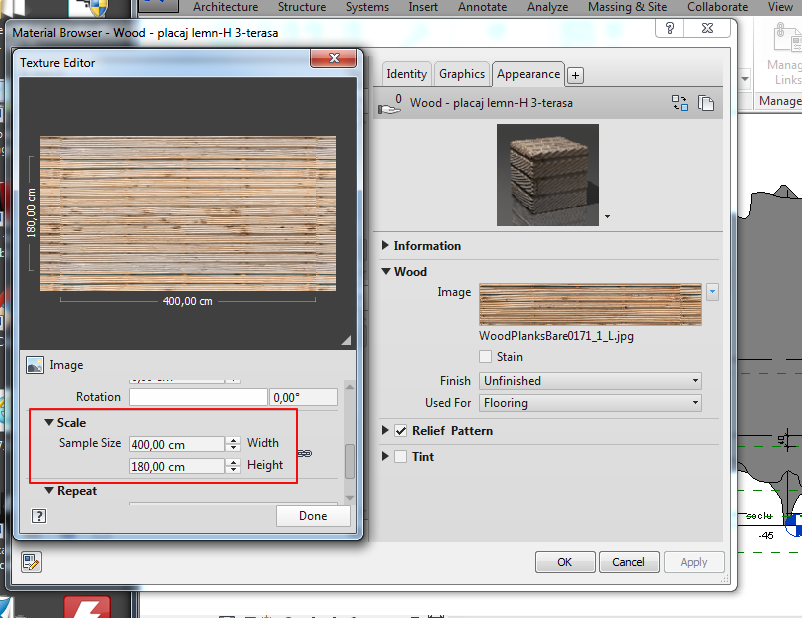

it happens to me too, sometimes, when rendering in Autotodesk 360 that maps scale appear overgrown . I understood that it happens only when working in metric ( the renderer consider by default you work in imperial units)...
In this case , I scale down the bitmap to fit my project .....Rendering in computer the map is too small , but in 360 becames ok.
