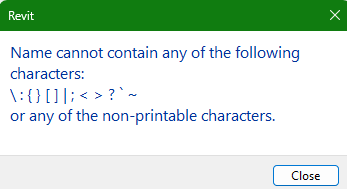

@mari.shimode using the [] brackets is not a workaround, it is specifically what they meant to do, they indicate that everything within them should be treated as one parameter name.
It is why certain characters cannot be used in parameter names as they have specific functions as a standard within operating systems and within Revit the [] brackets have been set to perform this function in parameter formulas.
