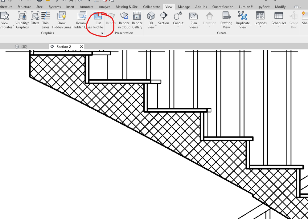

Issue 3: Slab gets this nasty jag. Any way to get rid of it?

You can fix the jag on section/elevation using Cut profile tool.
Oh, you can add with that tool too! I thought if was just for cutting things out (little arrow deciding what stays and what goes away).
