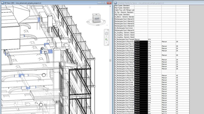

Is it possible to select or identify all the objects that are located in a particular Room or Space?

The solution is to make a multi-category schedule with the following categories:
Family and Type
Space: Number
Space: Name
Unfortunately it does not detect ducts or flex ducts, which is what I was trying to detect. I'm trying to find an easy and automated way to select everything that is in a hidden space, like plenums. It can detect duct fittings by space, but not individual ducts.... So it's kind of broken and useless.
I've attached the file in case someone wants to play with it.

@SamuelAB Select all the elements that you see in a mechanical elevation view; including all the elements that are in the plenum. Then filter the selection by Flex Ducts and Ducts. Then, enter "Plenum" in the Comments instance parameter. Then, make a schedule of Flex Ducts, and a schedule of Ducts, filtering by Comments = Plenum.
Message 6 of 11
SamuelAB
I don't believe that will work since I am looking to automatically differentiate between exposed ducts and plenum ducts.
We are looking to give InsiteVR customers easy methods to lower their Revit triangle counts. I was going to suggest detecting all the objects in uninhabited spaces and hiding them, the method needs to be almost full-proof and non-manual. I don't fully understand why ducts would not report spaces if they are fully embedded within a single space or room. It seems to me that Autodesk would just need to fix this.
Let me know if you come up with any other ideas.

The solution would be for Autodesk to fix this. I can see how duct work location within spaces/rooms can be ambiguous if the duct is within multiple rooms, but if it is fully bound within a room or space, they should give you access to its location.
This is probably the kind of thing they won't fix unless people complain.
