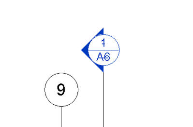

I'm trying to fix these these section heads because somehow there are still the dashes even if there is already a view assigned to it. Also, how do you fix the text size difference in my callout tag?

It's hard to tell from a your extremely pixelated screenshot. Are you indicating the spaces with the blue filled circles?
Have you checked the linetype setting for callouts. That might explain the gaps. Text size is set in the bubble family. Someone may have altered it to fit longer drawing numbers.
